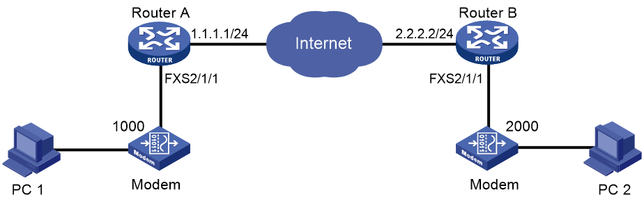

About FoIP
Fax over IP (FoIP) transmits and receives faxes over the Internet.
Figure 1 FoIP network diagram
Fax transmission operates in the following phases:
1.     Call establishment—The calling terminal sends a Calling Tone (CNG) to identify itself as a fax machine. The called terminal sends a Called Station Identifier (CED) tone to identify itself as a fax machine.
2.     Pre-message procedure—The calling or called terminals identify and negotiate the fax capabilities, including the modulation speed.
3.     In-message procedure—The calling terminal transmits fax packets in accordance with the T.4 procedure. Packet transmission control functions are performed (including packets synchronization, error detection and correction, and line monitoring).
4.     Post-message procedure—The calling or called terminal performs the control operations such as end-of-message signaling, confirmation signaling, and multipage signaling.
5.     Call release—Either the calling or called terminal disconnects the call.

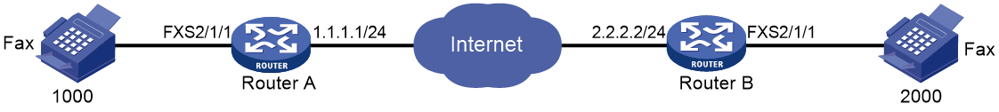

Example: Configuring T.38 fax
As shown in Figure 2, configure Router A and Router B to use the standard T.38 protocol for fax transmission.
Figure 2 Network diagram
1.     Configure Router A:
# Configure the called fax number as 2000 for VoIP entity 2000, and configure the destination IP address as 2.2.2.2.
<RouterA> system-view
[RouterA] voice-setup
[RouterA-voice] dial-program
[RouterA-voice-dial] entity 2000 voip
[RouterA-voice-dial-entity2000] match-template 2000
[RouterA-voice-dial-entity2000] address sip ip 2.2.2.2
# Configure the standard T.38 protocol for VoIP entity 2000, with a low redundancy value of 4.
[RouterA-voice-dial-entity2000] fax protocol standard-t38 ls-redundancy 4
[RouterA-voice-dial-entity2000] quit
# Configure the local fax number as 1000 for POTS entity 1000, and bind FXS interface line 2/1/1 to the POTS entity.
[RouterA-voice-dial] entity 1000 pots
[RouterA-voice-dial-entity1000] match-template 1000
[RouterA-voice-dial-entity1000] line 2/1/1
# Configure the standard T.38 protocol for POTS entity 1000, with a low redundancy value of 4.
[RouterA-voice-dial-entity1000] fax protocol standard-t38 ls-redundancy 4
2.     Configure Router B:
# Configure the called fax number as 1000 for VoIP entity 1000, and configure the destination IP address as 1.1.1.1.
<RouterB> system-view
[RouterB] voice-setup
[RouterB-voice] dial-program
[RouterB-voice-dial] entity 1000 voip
[RouterB-voice-dial-entity1000] match-template 1000
[RouterB-voice-dial-entity1000] address sip ip 1.1.1.1
# Configure the standard T.38 protocol for VoIP entity 1000, with a low redundancy value of 4.
[RouterB-voice-dial-entity1000] fax protocol standard-t38 ls-redundancy 4
[RouterB-voice-dial-entity1000] quit
# Configure the local fax number as 2000 for POTS entity 2000, and bind FXS interface line 2/1/1 to the POTS entity.
[RouterB-voice-dial] entity 2000 pots
[RouterB-voice-dial-entity2000] match-template 2000

Example: Configuring modem pass-through
As shown in Figure 3, configure modem pass-through on Router A and Router B for data communication between PC 1 and PC 2.
Figure 3 Network diagram
